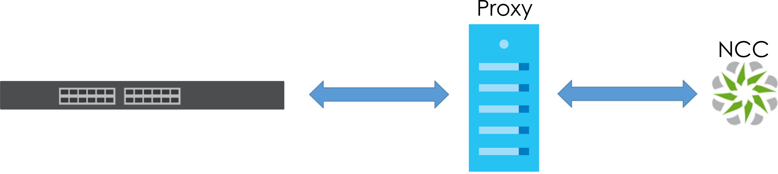

Cloud Management Overview
The Zyxel Nebula Control Center (NCC) is a cloud-based network management system that allows you to remotely manage and monitor Zyxel Nebula APs, Ethernet switches and security gateways.
The Switch is managed and provisioned automatically by the NCC (Nebula Control Center) when:
It is connected to the Internet.
The Nebula Control Center (NCC) Discovery feature is enabled.
It has been registered in the NCC.

Network Proxy Configuration
The proxy server of an organization may prohibit communication between the Switch and NCC (Nebula Control Center). Use this screen to enable communication between the Switch and NCC through the proxy server.
Network Proxy Configuration Application
As of this writing, this setting only allows communication between the Switch and the NCC.
