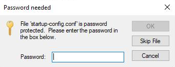

Download | Click a configuration file’s row to select it and click Download to save the configuration to your computer. Select Encryption if you want to add an encryption password to the downloaded zipped configuration file. Enter a password consists of 1 to 31 single-byte characters, with the following special characters !”#$%&’()*+,-./;:<=>@\^_‘{|}~ This field is case sensitive. []?and spaces are not allowed. You or another admin must use the same password to unzip the file. Unzip the Configuration File Password ![]() |

Encryption password | Enter a password consists of 1 to 31 single-byte characters, with the following special characters !”#$%&’()*+,-./;:<=>@\^_‘{|}~ This field is case sensitive. []?and spaces are not allowed. |
