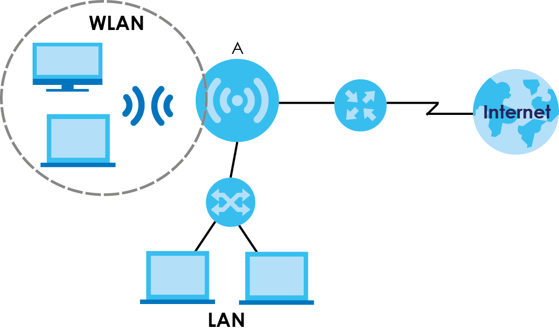

The Zyxel Device is in standalone mode by default. Use the web configurator to manage and configure the Zyxel Device directly. WiFi clients can connect to the Zyxel Device to access network resources.
