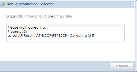

Diagnostics AP
This screen provides an easy way for you to generate a file containing the selected managed AP’s configuration and diagnostic information. You may need to generate this file and send it to customer support during troubleshooting.
Maintenance > Diagnostics > AP

Progress
This field displays the number of APs processed compared to the number of APs selected for processing.
Latest AP Result
This field displays the latest AP description and status
