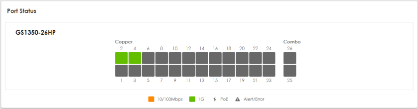

Port Status | This displays individual port type, status, and connection speed of the Switch. Click on a port to open the port’s status panel. Use the status panel to enable/disable a port, power cycle a PoE port, and view its basic information. For example, link speed and port utilization. ![]() |

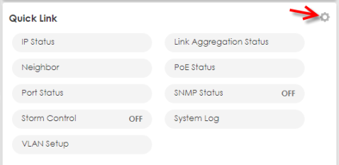

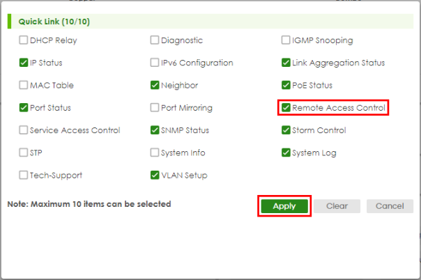

Quick Link | This section provides shortcut links to specific configuration screens. Click the edit button to choose the quick links to show. |
