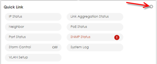

Quick Link
This section provides shortcut links to specific configuration screens.
Click the edit button to choose the quick links to show.

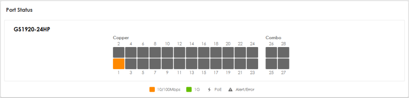

Port Status
The Port Status section provides visualized port status for monitoring. Each port displays a status color determined by the their link speed.
Port Status (example PoE model)
Click on a port to display a port’s status panel.
Port details Panel (example PoE model)
The port details pane includes the Power Cycle button for PoE models (turn the power off and then back on again), displays information such as link speed, status, PoE draw (for PoE models), port utilization, up time and has an ON/OFF switch button. Click the switch button to enable/disable the port.

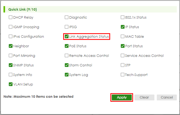

Quick Links to Use
The quick links in the Quick Link section provide shortcuts to specific configuration screens. You can use the quick links to directly access the screens that you would frequently use. You can also decide which quick links to be put on the DASHBOARD screen using the Edit button.
Quick Links (example PoE model)
The setup panel displays after you click the Edit button.
Quick Link Selection (example PoE model)
Select the quick links you want and click Apply. The selected quick links will be displayed in the Quick Link section on the DASHBOARD screen.
