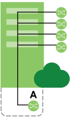

Maximum number of cluster members | 24 |
Cluster Member Models | Must be compatible with Zyxel cluster management implementation. |
Cluster Manager | The through which you manage the cluster member switches. |
Cluster Members | The switches being managed by the cluster manager Switch. |
label | Description |
Status | This field displays the role of this Switch within the cluster. Manager Member (you see this if you access this screen in the cluster member Switch directly and not through the cluster manager) None (neither a manager nor a member of a cluster) |
Manager | This field displays the cluster manager Switch’s hardware MAC address. |
The Number Of Member | This field displays the number of switches that make up this cluster. The following fields describe the cluster member switches. |
Index | You can manage cluster member switches through the cluster manager Switch. Each number in the Index column is a hyperlink leading to the cluster member Switch’s Web Configurator. |
MAC Address | This is the cluster member Switch’s hardware MAC address. |
Name | This is the cluster member Switch’s System Name. |
Model | This field displays the model name. |
Status | This field displays: Online (the cluster member Switch is accessible) Error (for example the cluster member Switch password was changed or the Switch was set as the manager and so left the member list, and so on) Offline (the Switch is disconnected – Offline shows approximately 1.5 minutes after the link between cluster member and manager goes down) |

Clustering Manager | The following fields relate to configuring the cluster manager. |
Active | Enable the switch button to have this Switch become the cluster manager switch. A cluster can only have one manager. Other (directly connected) switches that are set to be cluster managers will not be visible in the Clustering Candidates list. If a Switch that was previously a cluster member is later set to become a cluster manager, then its Status is displayed as Error in the Cluster Management Status screen and a warning icon appears in the member summary list below. |
Name | Type a name to identify the Clustering Manager. You may use up to 32 printable ASCII characters except [ ? ], [ | ], [ ' ], [ " ], or [ , ]. (spaces are allowed). |
VID | This is the VLAN ID and is only applicable if the Switch is set to 802.1Q VLAN. All switches must be directly connected and in the same VLAN group to belong to the same cluster. Switches that are not in the same VLAN group are not visible in the Clustering Candidates list. This field is ignored if the Clustering Manager is using Port-based VLAN. |
Apply | Click Apply to save your changes to the Switch’s run-time memory. The Switch loses these changes if it is turned off or loses power, so use the Save link on the top navigation panel to save your changes to the non-volatile memory when you are done configuring. |
Cancel | Click Cancel to begin configuring this screen afresh. |
