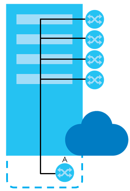

Maximum number of cluster members | 24 |
Cluster Member Models | Must be compatible with Zyxel cluster management implementation. |
Cluster Manager | The through which you manage the cluster member switches. |
Cluster Members | The switches being managed by the cluster manager Switch. |
label | Description |
Status | This field displays the role of this Switch within the cluster. Manager Member (you see this if you access this screen in the cluster member Switch directly and not through the cluster manager) None (neither a manager nor a member of a cluster) |
Manager | This field displays the cluster manager Switch’s hardware MAC address. |
The Number Of Member | This field displays the number of switches that make up this cluster. The following fields describe the cluster member switches. |
Index | You can manage cluster member switches through the cluster manager Switch. Each number in the Index column is a hyperlink leading to the cluster member Switch’s Web Configurator. |
MAC Address | This is the cluster member Switch’s hardware MAC address. |
Name | This is the cluster member Switch’s System Name. |
Model | This field displays the model name. |
Status | This field displays: Online (the cluster member Switch is accessible) Error (for example the cluster member Switch password was changed or the Switch was set as the manager and so left the member list, and so on) Offline (the Switch is disconnected – Offline shows approximately 1.5 minutes after the link between cluster member and manager goes down) |
