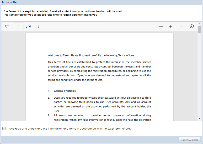

I have read and accept the SecuReporter Terms of Use.
Read the Terms of Use and then select this if you agree with them.
Complete and Close Window
Review your configurations and then click this to apply the SecuReporter settings for this Zyxel Device.
