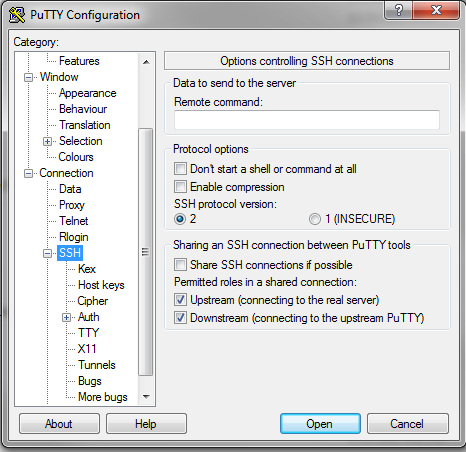

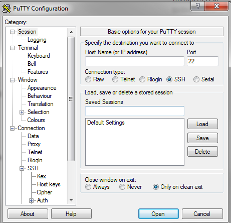

Label | Description |
Create new Object | Use this to configure any new settings objects that you need to use in this screen. |
Address Object | Select ALL to allow or deny any computer to communicate with the Zyxel Device using SSH. Select a predefined address object to just allow or deny the computer with the IP address that you specified to access the Zyxel Device using SSH. |
Zone | Select ALL to allow or prevent any Zyxel Device zones from being accessed using SSH. Select a predefined Zyxel Device zone on which a incoming service is allowed or denied. |
Action | Select Accept to allow the user to access the Zyxel Device from the specified computers. Select Deny to block the user’s access to the Zyxel Device from the specified computers. |
OK | Click OK to save your customized settings and exit this screen. |
Cancel | Click Cancel to exit this screen without saving. |
login as: admin Using keyboard-interactive authentication. Password: % session is not found Bad terminal type: "xterm". Will assume vt100. Router> enable Router# |
