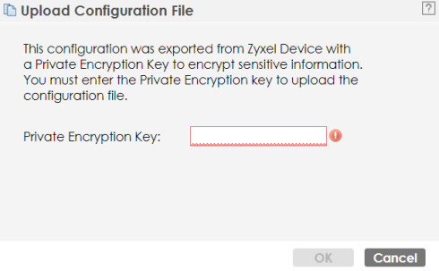

Sensitive Data Protection
The Zyxel Device by default encrypts local admin and user account passwords for web configurator and CLI.
Enable Sensitive Data Protection to have the Zyxel Device use a private key to encrypt local admin and user account passwords for web configurator and CLI.
*You can only upload configuration files using FTP that are using the current private key of the Zyxel Device.
The following examples describe the situations you might come across using Sensitive Data Protection.
Example 1:
1 Download a configuration file (file1).
2 Enable Sensitive Data Protection.
3 Create a private key (key1).
4 When you upload file1 to the Zyxel Device through the Zyxel Device web configurator, you do not need to enter the private key (key1). Configuration file1 is not encrypted by the private key (key1).
Example2:
1 Enable Sensitive Data Protection.
2 Create an private key (key1).
3 Download a configuration file (file2).
4 You must use key1 to upload file2 to the Zyxel Device because file2 is encrypted by key1.
Example 3:
1 Change the private key from key1 to key2.
2 Download another configuration file (file3).
3 You must use key2 to upload file3 to the Zyxel Device.
*You must still use key1 to upload file2 to the Zyxel Device. Make a note of the key to use when you change the private key and then download a configuration file.
Example 4:
1 Enable Sensitive Data Protection on Zyxel Device1 and create a private key.
2 Download a configuration file from Zyxel Device1.
3 You must upload this configuration file using the private key you created on Zyxel Device1 to Zyxel Device2 even if Sensitive Data Protection is not enabled on Zyxel Device2.
Enable
Select this to enable Sensitive Data Protection; see Overview for more information.
You need this key to upload configuration files. Write down the key you set and keep it in a safe place.
Upload Configuration File
Enter Private Encryption Key
Enter the encryption key in this field. The encryption key should be 4-8 single byte printable characters, including 0-9a-zA-Z`~!@#$%^&*()_-+={}|\;:'<,>./]|.
Re-enter Private Encryption Key
Enter the encryption key again in this field.
