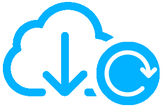

The following table explains the Upgrade icons in the web configurator.
Cloud Helper Firmware Icons
Cloud Helper New | A later firmware is available on the Cloud Helper Server. Click this icon to display a What’s New pop-up screen. You need a Firmware Upgrade license to upgrade the firmware. If you do not have a license, Upgrade Now is grayed out. If you have a license, click Upgrade Now to directly upgrade firmware to the standby partition and have the Zyxel Device reboot automatically so that the new standby firmware becomes the running firmware. The previous running firmware becomes the standby firmware. If you haven’t registered the Zyxel Device, a message will appear and remind you to register it. Also, Upgrade Now is grayed out. |
Cloud Helper Downloading | Cloud firmware is being downloaded from the Cloud Helper Server. If you select another partition or the local firmware upgrade icon, you will see the following warning message. When firmware is downloading, you can pause, resume, stop or retry the firmware download. |

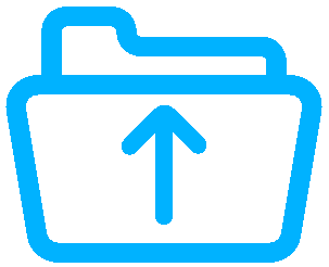

Local Firmware | Use this if you have already downloaded the latest firmware from the Zyxel website to your computer and unzipped it. Click the icon and then browse to the location of the unzipped files. If you upload the latest firmware to the running partition, the Zyxel Device will reboot automatically when it finishes uploading. If you upload the latest firmware to the standby partition, a message will appear to ask if you want to reboot the Zyxel Device. |
