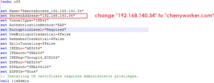

Windows 11 will not verify the certificate used in the Remote Access IPsec VPN script.
If the Remote Access IPsec VPN policy uses an interface, the ServerAddress in the downloaded Windows script will be the interface IP address. However, if the issuer of the certificate is a domain name instead of an interface IP address, then Windows 11 will not verify the certificate.
In the certificate, the issuer of the certificate is shown in the Subject field (using the domain name, cherryworker.com for example).
To fix this you must edit the downloaded script using a text editor as follows. Change the ServerAddress IP address (192.168.140.34) to the domain name used in the Subject field of the certificate as shown in the above example certificate. Save the certificate, then use it in your IPSec VPN client on your Windows 11 computer.
